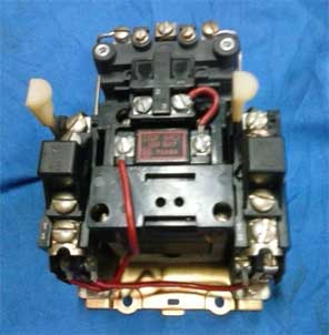

In the world of manufacturing, whether it be heavy industrial or light production, wherever you find an electric motor there's always a contactor to drive and operate that motor. A contactor is simply an electrically controlled switch, also called a relay, used for switching a power circuit.
It is designed so that when sufficient current flows through a coil built into the contactor, the magnetic field which is generated causes the contacts to be pulled in.
The contacts, in turn operate as the switch. The contacts are appropriately sized by the designer of the particular circuit to handle current flow without overheating. Contactors are sold in a variety of sizes for specific applications.
The design of the contacts themselves permit the contactor to be opened and closed repeatedly with minimal damage. This, of course can and will vary depending on the load current and failure can come rather quickly to an improperly sized contactor.
Contactors are designed and built in two popular configurations, single phase (or single pole) and three phase (three pole). This designation merely signifies the number of circuits that can be operated simultaneously. The coil is the means of operating the contacts.
When it is energized with an appropriate voltage, it generates enough magnetic force to pull the contacts into a closed position, or close the power circuit.
When the coil circuit is opened, spring pressure returns the contacts into the open position threrefore opening the power circuit. Coils are usually designed to accept a variety of popular voltages including 12, 24, 120, 240, and 480 volts AC as well as some DC control voltages like 12 and 24 volts. Other non-standard or less popular voltages are available as well.
